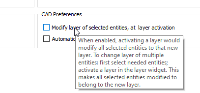

If you want to change multiple items you have to activate Edit -> Application Preferences -> Default Tab check box  "Modify layer of selected entities, at layer activation.
WARNING: remember to turn this off after use otherwise any selected entity will change layers all the time
If you have the 0 layer selected and then check the box the entity selected will not change to that layer until you click on the 0 layer. So if you want the entity selected to be on that layer and it is select when you turn on the feature just select that layer agai after turning on the feature.
After you have completed all your entity layer changes go back into that setting and unselected the check box.
I hope this helps speed up your layer changing needs.

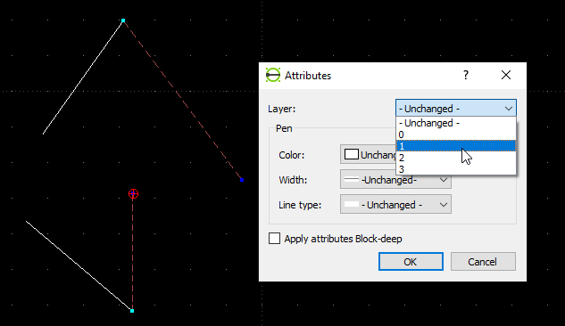

With Modify - Attributes you can select multiple entities.
Both methods work perfectly:
For the second methode there is a little complication:
