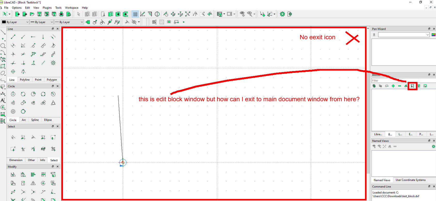

Greetings everyone!
I have created a simple block and I have been trying to edit. I have two questions:
1.Without tiling windows how can I return to the main document window?

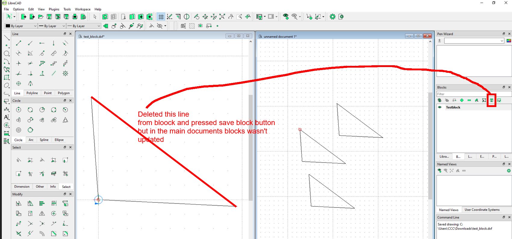

2.I deleted a line from block but the main document blocks not updated but after saving and opening again the file all bloocks updated.Is this normal behaviour?
Workspace -> at the bottom, select the document
Obviously not, additionally I've found that if one adds and deletes some  things, then the block is updated only with the added things ???
Worth a bug report?
https://github.com/LibreCAD/LibreCAD/issues
