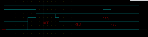

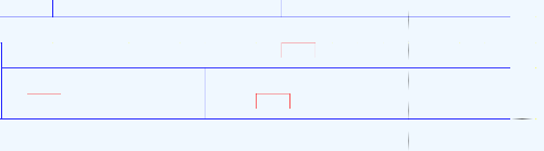

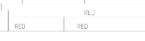

Hello,
I don't have draft mode on but my added text and dimensions appear as rectangles in the drawing, but it shows correctly in the print preview. Please see the attached examples, the red rectangles represent the text in the drawing. Thanks.

It's likely due to zooming.
The current mechanism is to avoid rendering text in tiny scales.
Could you zoom in to see the text?
If needed, please upload a sample dxf with the issue.

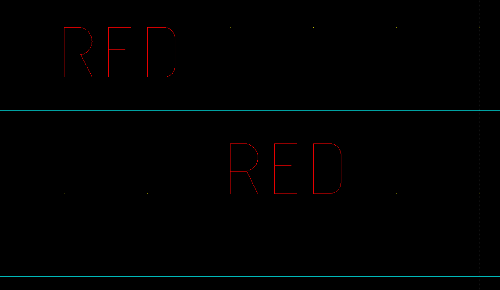

I just opened the drawing and the text was visible? I zoomed in very close and then out and it was still visible in the drawing and print preview.  I closed and reopened several times and it was still showing even though I closed and reopened several times the other day before I looked at the LibreCAD site for help.  I dont know what happened, but so far today, so good.  Thanks.
Re: Text as rectangles in drawing but shows in print preview
No problem. We are constantly reviewing our code and fix issues on the way.
If the issue just shows up again, please upload a minimum sample dxf for us to troubleshoot.
