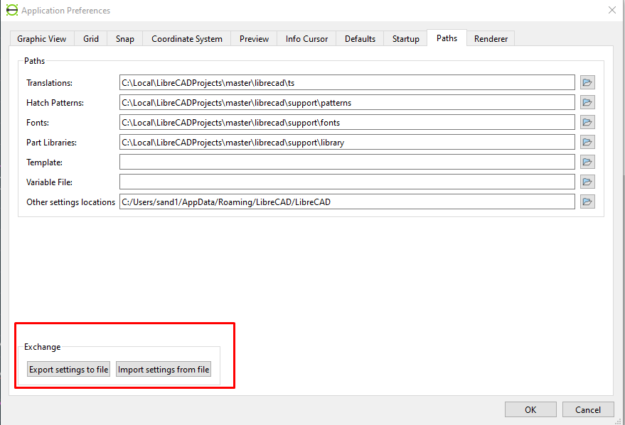

we already have export/import in 2.2.2, so you could try to download this version, export settings and import them back on another computer.  Most of settings should be transferred, and you could then user the production version 2.2.1.
You can download 2.2.2 (dev alpha, not for production) here:
https://github.com/LibreCAD/LibreCAD/releases/tag/2.2.2_alpha-latest
