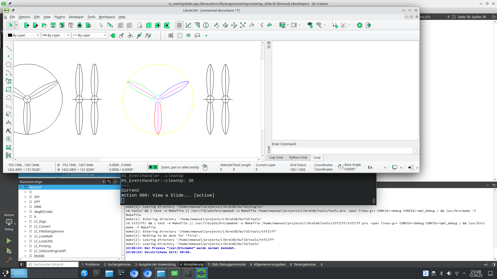

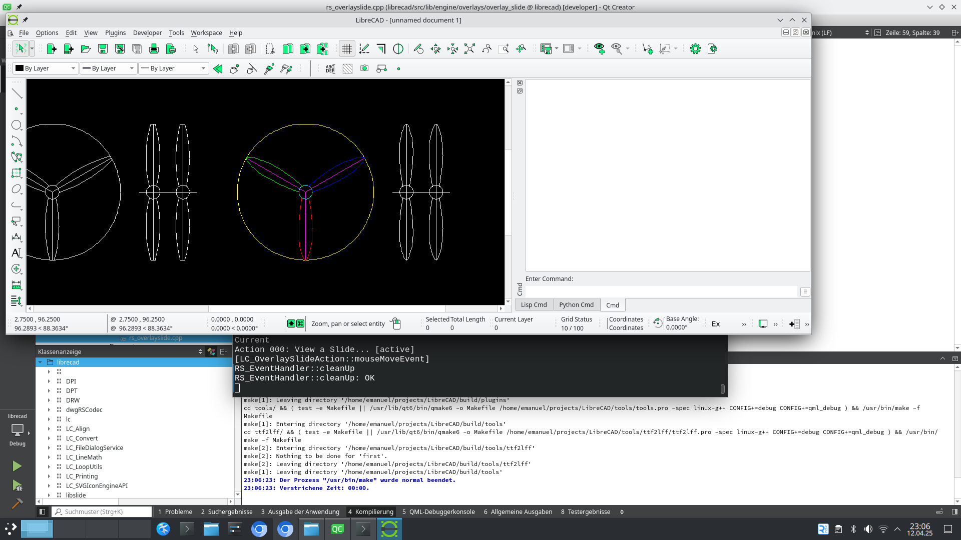

emanuel
I'm not really making any progress.
I have a class:
class LC_OverlaySlideAction:public RS_ActionInterface {
public:
    LC_OverlaySlideAction(
        const char *name,
        RS_EntityContainer &container,
        RS_GraphicView &graphicView,
        RS2::ActionType actionType = RS2::ActionNone);
    ~LC_OverlaySlideAction() override = default;
    void init(int status) override;
    void finish(bool updateTB = true) override;
    void trigger() override;
    void mouseMoveEvent(QMouseEvent* e) override;
    void mousePressEvent(QMouseEvent* e) override;
    void mouseReleaseEvent(QMouseEvent* e) override;
protected:
    void drawOverlaySlide(const QString &fileName);
private:
    bool middleButtonPressed{false};
but when I end the action with "ESC," RS_EventHandler::killAllActions() always calls RS_ActionInterface::finish(), never the overridden LC_OverlaySlideAction::finish().
Why doesn't this work? I have to reset values on finish.
Even weirder is, if I add just a virtual void bla() {} to the public: property of the RS_ActionInterface class, the entire LC crashes.
If I add it in different places, LC crashes in completely different places.
Once with QWidget attributes, or RS_Snapper.
Strange behavior.

Suddenly I can control all the events: I can now end the "vslide" command with the gestures "Pan", "Zoom", "ESC".
Unfortunately, it only works with the 2 switches here:
https://github.com/emanuel4you/LibreCAD/blob/developer/librecad/src/ui/view/qg_graphicview.h#L121
to get events like:
https://github.com/emanuel4you/LibreCAD/blob/developer/librecad/src/lib/actions/rs_actioninterface.h#L87
The result is very good, please take a look at the video:
simplescreenrecorder-2025-04-12_13.mp4
However, I have a shortcoming, I don't get to the background color, which is always "black".
https://github.com/emanuel4you/LibreCAD/blob/developer/librecad/src/lib/engine/overlays/overlay_slide/rs_overlayslide.cpp#L44
Do you have an idea why?

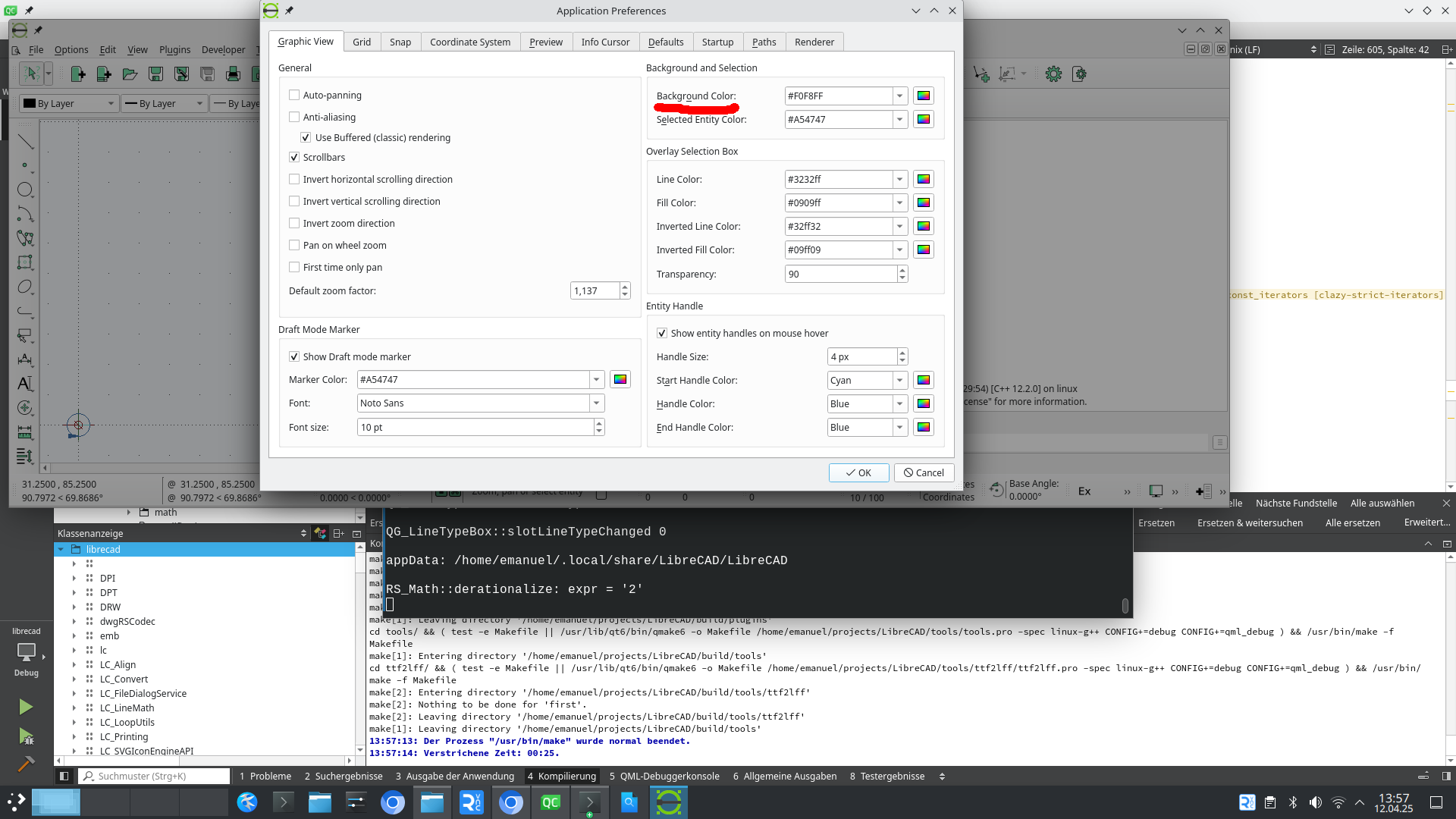

I need the current setting, set by:
Re: [@dxli and @sand1024] please a tip for the RS_Eventhandler
Then, use RS_Settings should be something like:
    LC_GROUP_GUARD("Colors");
    auto bgc = QColor(LC_GET_STR("background", RS_Settings::background));
    RS_Color fillBackground{bgc};
The RS_Settings::background is a static const, not actually set by the GUI user setting. Maybe, we should make it consistent with the user setting.
emanuel
Color works now, thanks!
emanuel
Now I'm happy.
I built a cleanup function, getEventHandler()->killShownActions(); similar to killSelectActions(). This allowed me to reset 80% of the patch. I no longer need switches, the RS_ActionInterface is back to original, and I no longer need a wheelEvent in the action. And everything works, even the zoom buttons and the command line eliminate the slide display. :-)
