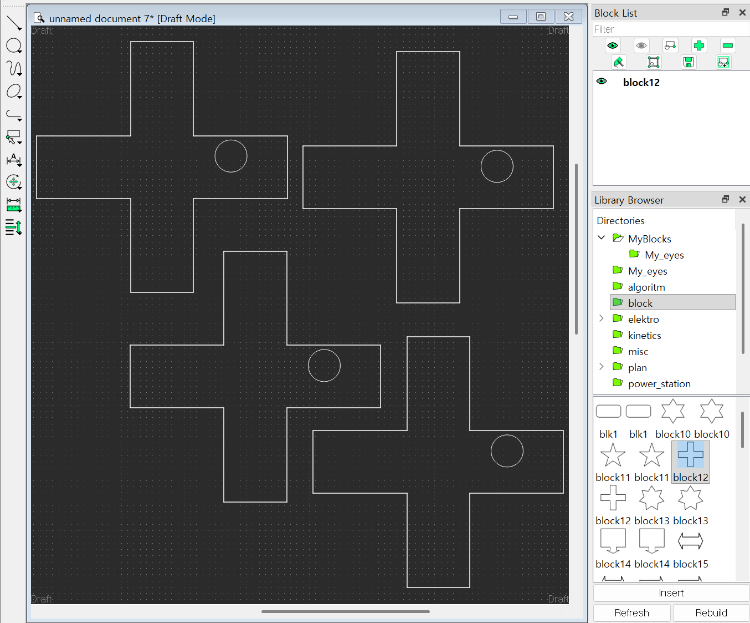

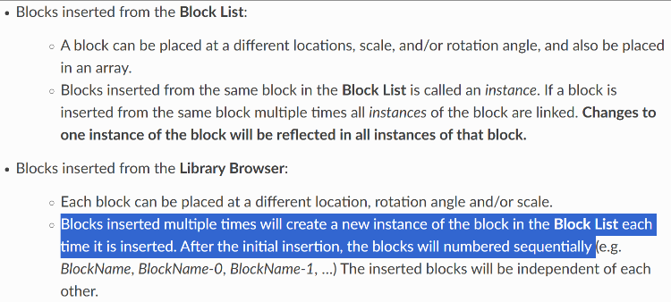

According to the manual, blocks are supposed to behave slightly differently depending on whether they are inserted from the Block List or from the Library Browser.
However, in my case, I don’t see any difference — they all behave as if inserted from the Block List.
For example, when I insert the cross-shaped block (block12) multiple times from the Library Browser, only a single instance is created in the Block List. If I modify one of the inserted blocks, the changes affect all of them.
LC 2.2.1.5
Windows 11
Re: Block inserted from the BlockList vs LibraryBrowser
sand1024
well, the documentation may be outdated.
Anyway, I'm going to review both library and blocks widget and make some face-liftings there.
