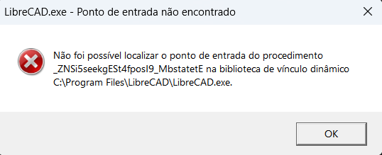

I installed LibreCAD 222 on Windows 11, but it is not opening, displaying the following message:
The procedure entry point could not be located... in the dynamic link library. C:\...

Sorry, continuous build for Windows seems to be broken at the moment.
https://github.com/LibreCAD/LibreCAD/issues/2085
If you have access to Linux you can try the appimage, it works.
