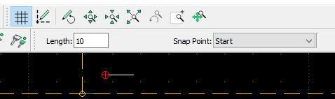

dellus
Look at the tools options bar above the drawing area. It's contents change according to the tool in use.
