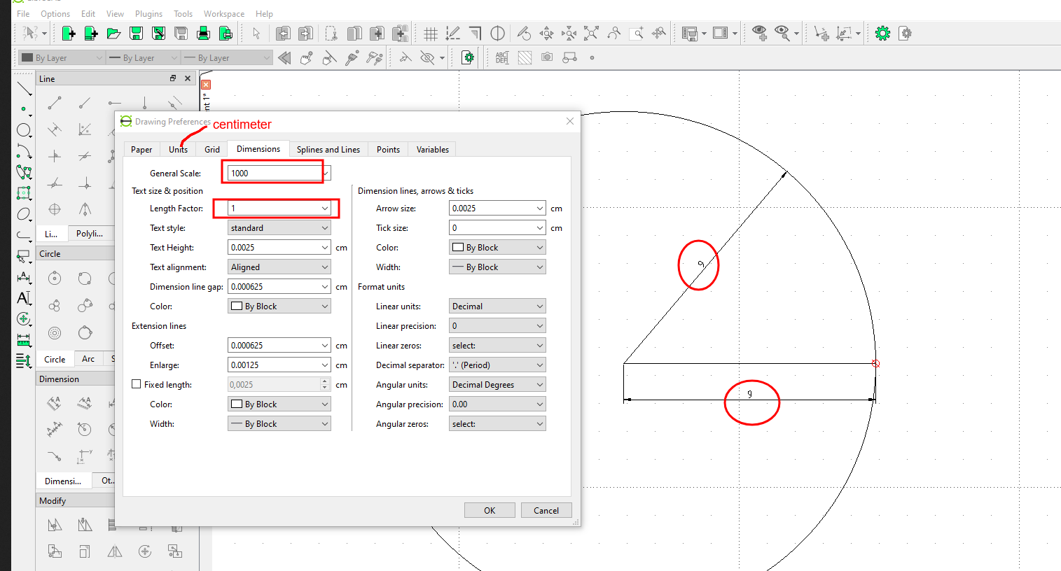

Greetings everyone!
I made drawing unit as centimeter and draw a horizontal line with entering 90 and a circle with radius 90.When I dimension horizontal line that shows just 9 not 90.I also used radial dimension and that is also 9.

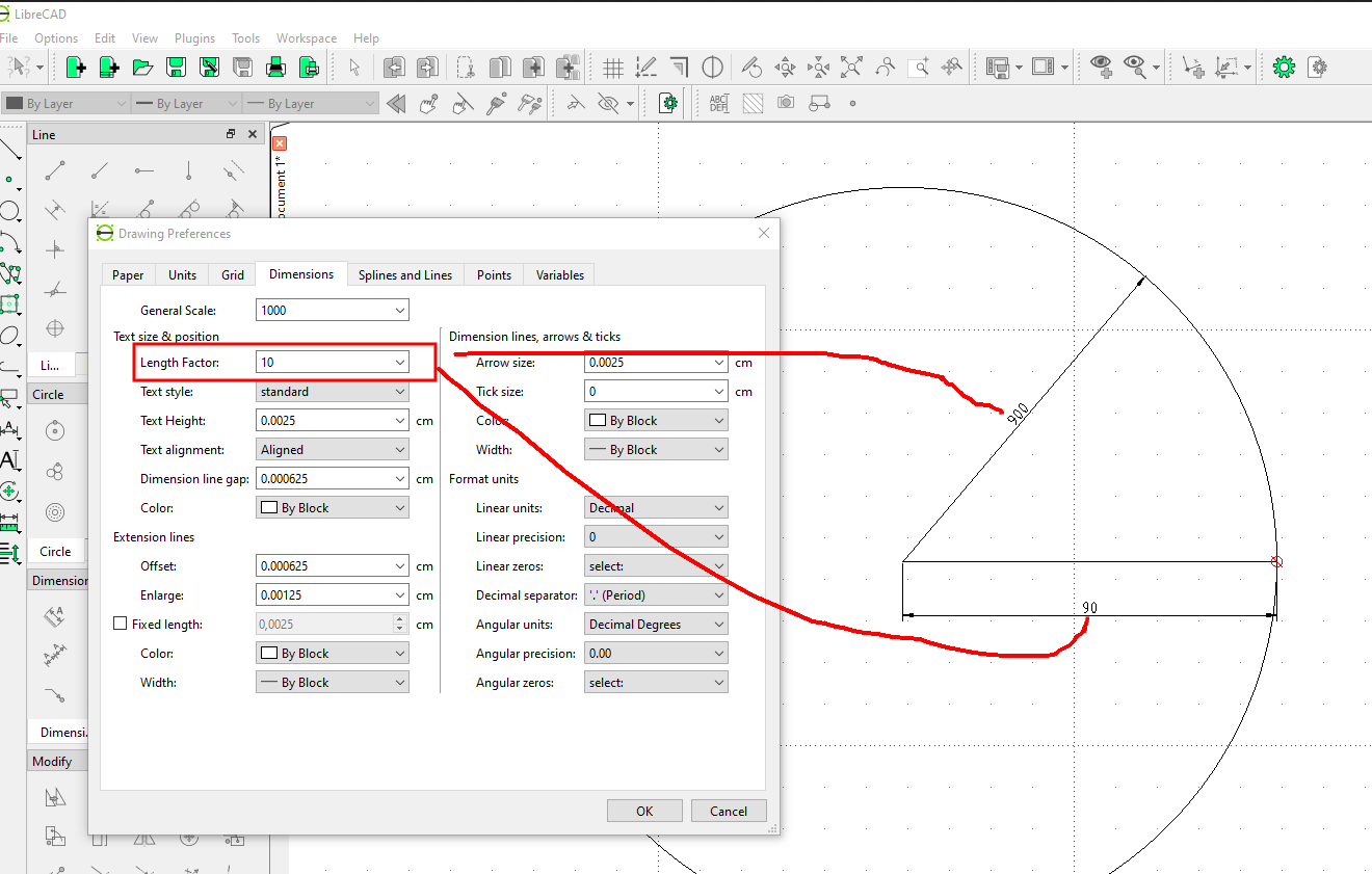

so I changed length factor to 10 .Now I have my 90 on horizontal dimension but now I have 900 as radial dimension.
Am I doing anything wrong?
