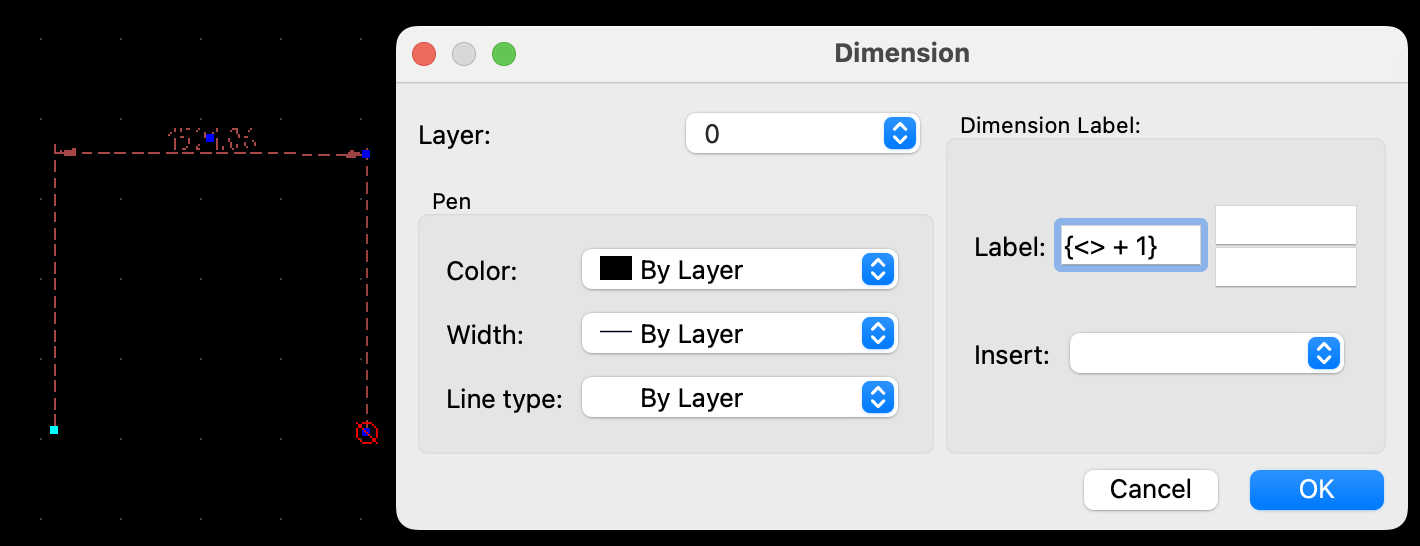

currently(2.2.1.1), you may double click on any entity to modify the properties.
Particular for dimensions, if I got your comment correctly, to display the dimension value larger by 1, {<> + 1}:
You can even display by a functional value, say square of the dimension by using {<>*<>}
