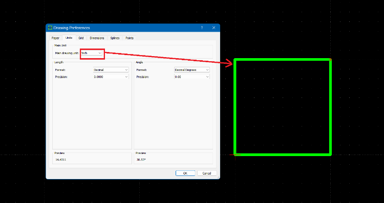

In reply to this post by dxli
Hey friend, since previous versions of LibreCAD I've noticed that when the software units are in inches, the line width appears thick on screen, but when working in meters, the line width isn't visible. Is this normal? Is it possible for the line to appear thick when working in meters?
