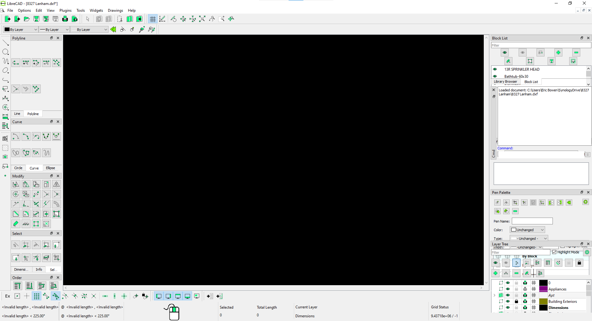

I've been working on blueprints for renovating my garage apartment. Everything was going well until yesterday, when something glitched. Now, the drawing will load...but as soon as I try to adjust the zoom, it goes nuts...as in zooming out all the way to California. And, so far, I haven't been able to recover it. Attempting to insert a screenshot. Here it is when I open the file:

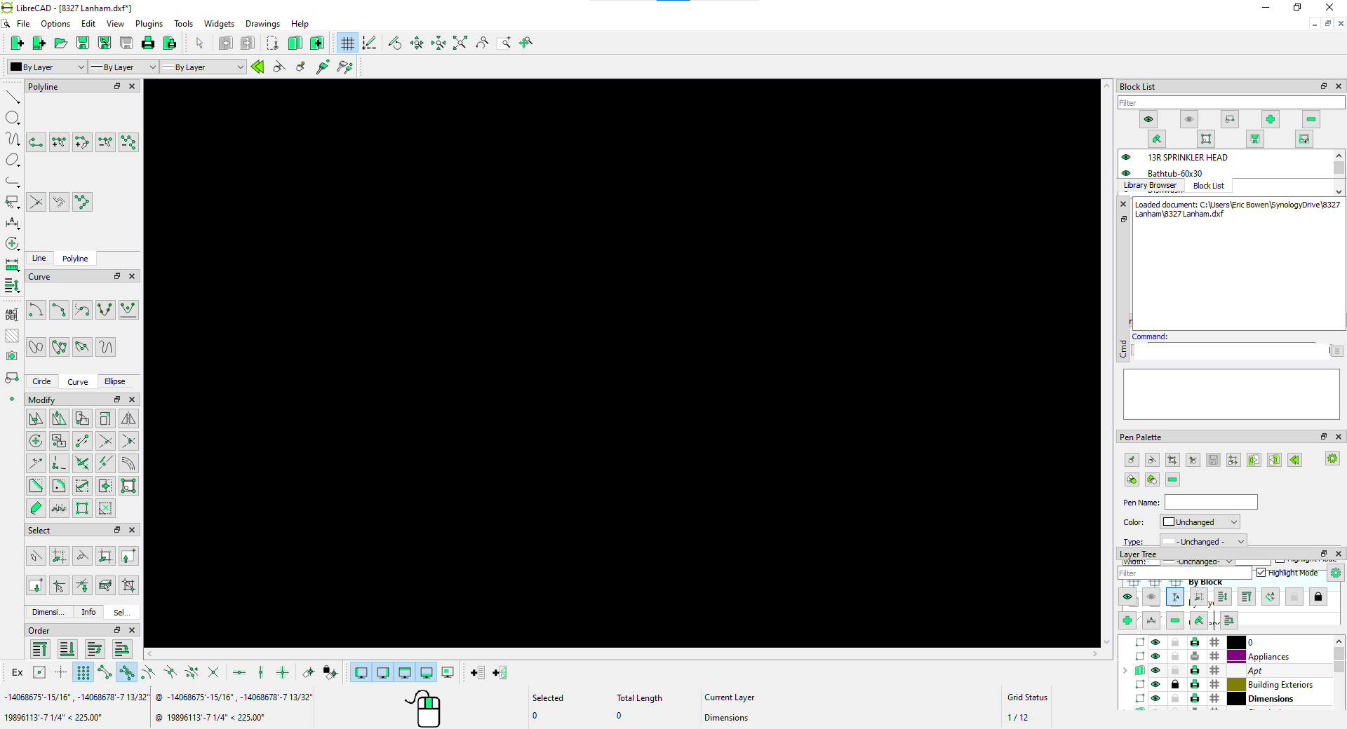

Make one click of the mouse wheel to zoom the drawing, and I get this. Notice the dimensions/distances:
Touch anything else, at all, and I get this: "Invalid length" everywhere:
I suspect that somewhere LibreCad is dividing by zero, but I don't know how or where it might have started. I did get a warning that "page size is less than 1 mm" or something to that effect when this first started...but the page size in current drawing preferences (US Letter) isn't showing any problems.

Note that the problem is specific to this file; I can create and save a new file with no issue.
